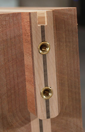

The best way I've found is to pre-tap the holes. This allows you to make your hole smaller to start with and just about completely elimates the possibility of splitting.
Taps in the needed size are not commercially available, so I made mine. I made two t-handle wrenches. One for tapping the hole, and one for installing the insert. They're about 8 inches long to make it easier to keep it going straight.
I'm going to be offering a kit once I get caught up that will include the wrenches, a hard to find but perfectly sized drill bit (.336") and a hundred or so of the best inserts (I've tried them all).
It makes for a worry-free job with a clean look.

Hey John....
The mahogany on the right edge of that tenon looks to be a good .0175" thicker than on the left side of the tenon....better check your azimuth again...
Nice looking work...
That kit should be a big seller. The issue I've always had with threaded inserts is that they always expect you to tap them with the inserts themselves. That makes no sense to me...
